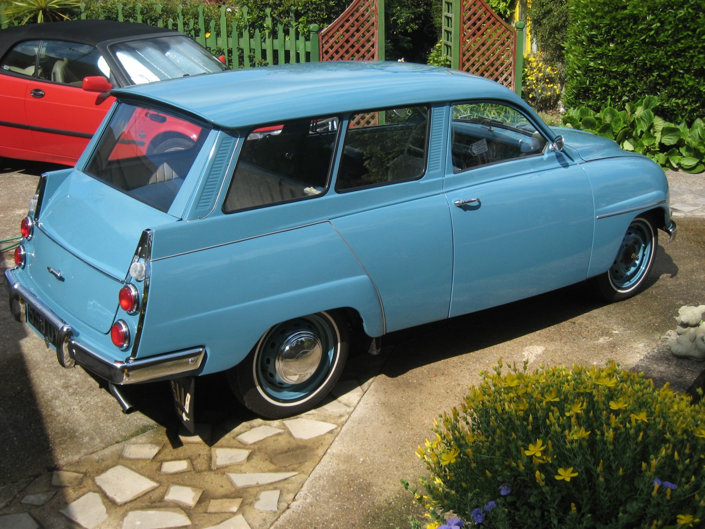

      Has anybody tried the heavy duty rear springs – part number 720059-SA available from the club shop on their two-stroke 95?
      The rear springs on my 1960 95 need replacing and I cannot find any new standard springs for sale. Someone mentioned that you can use cut-down two-stroke front springs on the rear of a 95. Does anyone have any experience or opinion?
      I have new early V4 springs on the front and adjustable shock absorbers, and have removed the rear lever arm shock absorbers and have telescopic ones fitted. So the front is a little stiffer than standard – i just have to stiffen up the rear a little. Anyone’s advice would be most welcome. My apologies for writing in English. Tony.
